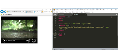

I want to use NI web server to allow acces remotly on a webpage with html video.
If you take that simple code on test.html and the video mov_bbb.mp4 and place it on
C:\Program Files (x86)\National Instruments\Shared\NI WebServer\www\test
http://localhost:8080/test/test.html
The webserver do not allow to play the video.
Do we need to change a INI file of the web server to allow html 5 video?

Hello Samuel,
I tried to do it on my computer and had no issue. I just modified the path of the video file for the browser to find it.
The URL used is: http://localhost:8080/test.html
I put in attachment the html file used. I also tried with your video successfully.
Can you test to see if the behaviour is still generating an error on your side?
