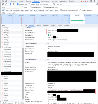

Hello, I need help figuring out how to translate clicking of a button "Restore configuration" in web browser to LabVIEW syntax. This is what source code looks like and what it looks like in Chrome - I need to use POST method with content type "multipart/form-data"

I was following this tutorial by LabVIEW to upload that file, but it doesn't look like I got syntax correctly, I get error 363514, my code is attached.

Any suggestions where to continue looking? I've tried changing the header by using Accept to match that of Chrome, but I keep getting the same error. I know that JSON file definitely has correct structure and I have not issues using LabVIEW to send GET commands to the web page to download a file, force log out, etc., I only struggle with implementing this multipost button.

Yes, the example written by NI I've referenced shows that if the form is written with regular HTML code, it would would work, but my button seems to be a function or a  class of AJAX library, so I need to apply some logic glue and this is what I can't figure out how to do.
