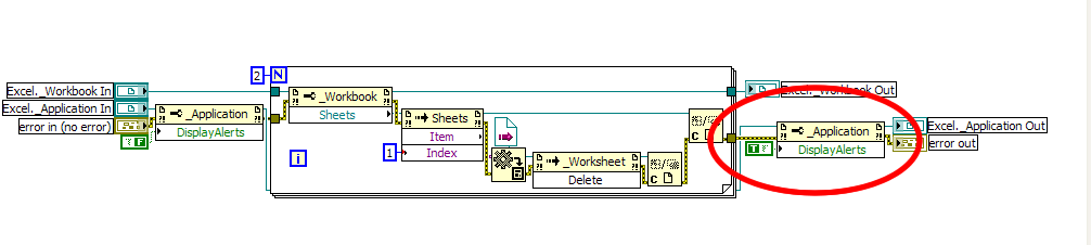

This is what we did for this situation. If you look at the picture where it is circuled is how you show errors that Excel will throw.
