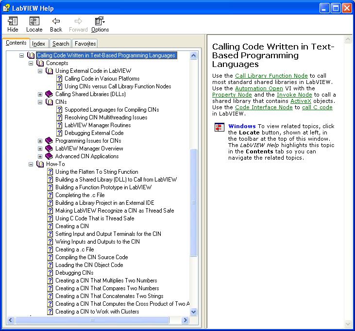

However, if you're still set on using CINs, the "Using External Code In LabVIEW" help is a great resource. (I assume you're using LabVIEW8). If you go to Help>>Fundamentals>>Calling Code Written in Text-Based Programming Languages, I think you'll find some really good information in there. See the attached picture.
