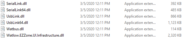

I've used it in the past. I do remember having to find certain dll's. I can't remember the specifics, but this is what my support directory looked like for that build.

Thanks. That fixed it. What threw me off was that the Serial*.dll and USB*.dll files were not listed as dependencies. Thanks.
