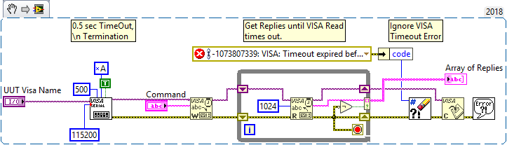

Sorry I missed your VIs (thanks for attaching).  Also, thanks for the MAX tests.  Here's a routine that should work for you (Famous Last Words):
Multi-line VISA ReadMulti-line VISA Read
The VISA Configure Serial Port has the inputs for Termination Characters (so you don't need a Property Node).  I also set the Timeout from 10 seconds to 0.5 seconds, assuming that when you give a Command, you'll get the response within half a second.
     For the Read, I ask for 1024 characters (knowing I should get fewer).  As long as the Read doesn't time out, I stay in the Loop and accumulate the lines in an Indexing Tunnel, using a Conditional Terminal to not output the non-existent line when the Timeout (an Error) occurs.  The Error should be -1073807339, VISA Timeout expired on Read, so I clear this specific Error and can then proceed.  [For this example, I just quit, but you could do multiple Command/Response cycles].
     You had most of this in your first VI, but didn't have the code to do multiple Reads per Command.  To be honest, I've not encountered multi-line Responses (other than when you start an Instrument and say "Send me lines forever at 10 Hz"), so it didn't occur to me to mention this earlier.
Bob Schor

Tried out the new method. Attached the .vi below. Results still intermittent.
When I removed the "TermChar" property node for Visa Write, it ended up causing issues and Visa Write would push all my lines from my text file and write the commands in 1 line, so I put it back in to ensure it was terminating after each write.
Code is cleaner, but I am still not capturing the entire response. The result of what I'm capturing is clearer now though since it seems like the "Visa Read" is reading the response too late. To clarify this I have attached 2 text files again, 1 being my expected output and 1 being the failing output. You can see in the failing text file that the "Visa Read" seems to almost be running too slow to capture the first half of the response that happens right after I send my Visa Write command to my device.
