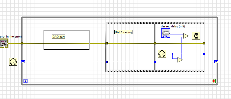

The 2000 mS timer's execution is not in parallel with the execution of the rest of the loop it is in, it is most likely before or after the core executes, thereby doing the 2000+execution time timing you are seeing. You can make a determination of the actual data acquisition timing, and change the loop delay accordingly.
Ideally you would have error checking at the time difference calculation for those instances where the daq time went over the desired delay, so that you don't send a "negative number", which, as these are U32 values, would be a VERY large number (no sign value for Unsigned Integers!) , on the order of  4.3 billion seconds!.
Also, the cleaner way, as mentioned earlier, is using the "Timed Loop" structure.
adjusted loop timing

Thanks for the example VI Putnam. I did try something like that and it can work, but I still don't understand why the timer is not running in parallel. The LabVIEW documentation indicates that it should, and the example snippet I posted on my first post (the smaller snippet) seems to indicate that it does indeed work in parallel as I do see the expected behavior in that piece of code.

The timer function doesn't run in parallel when it is in the same loop. It will run, then everything else that is connected by "data flow", which in this case it the error wire. Or everything else will run, then the timer. It is just the way it is, and has been. To get things to operate in parallel they essentially have to be placed in different loops, which I guess signals the compiler to handle them that way.
