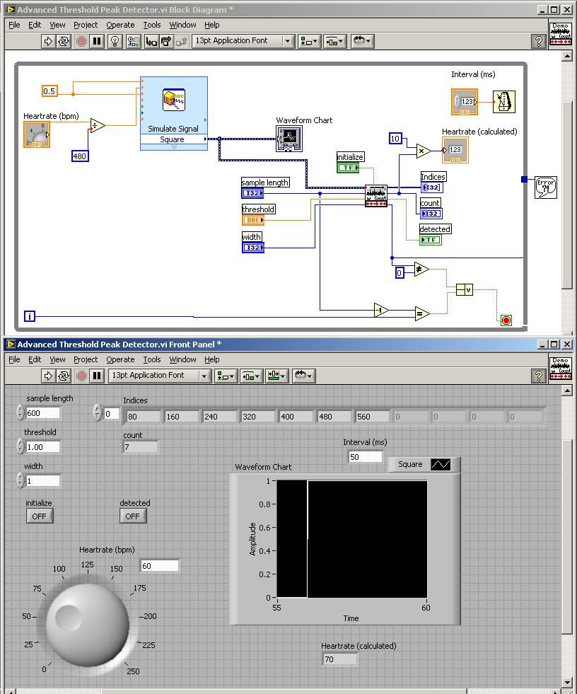

@mathan - I hope you don't mind if I continue using this thread as it is the correct
category and I can't move the original.
@t06afre - Hello again! Thanks for replying.  When you say "I would have added an
extra analog channel for the "digital" heart rate signal" what do you mean?  I've
combined the example VI you suggested with my simulated square wave to give the
following.
Peak Detector
It is ALMOST operating correctly.  Although I notice because my square wave's initial
value is 1 it misses one beat, yet it's returning a count of 7 for a 60 bpm heartrate.
I need to go to a lecture just now, I just thought I'd let you know how I'm getting on.
Pete

Hi
This is very simple. In your picture it has been counted 7 valid peaks. This implies you have a frequency equal to  (number of samples*dt)/7. Multiply this with 60 and you have the heart rate in BPM
Message Edited by t06afre on 03-16-2009 03:21 PM
