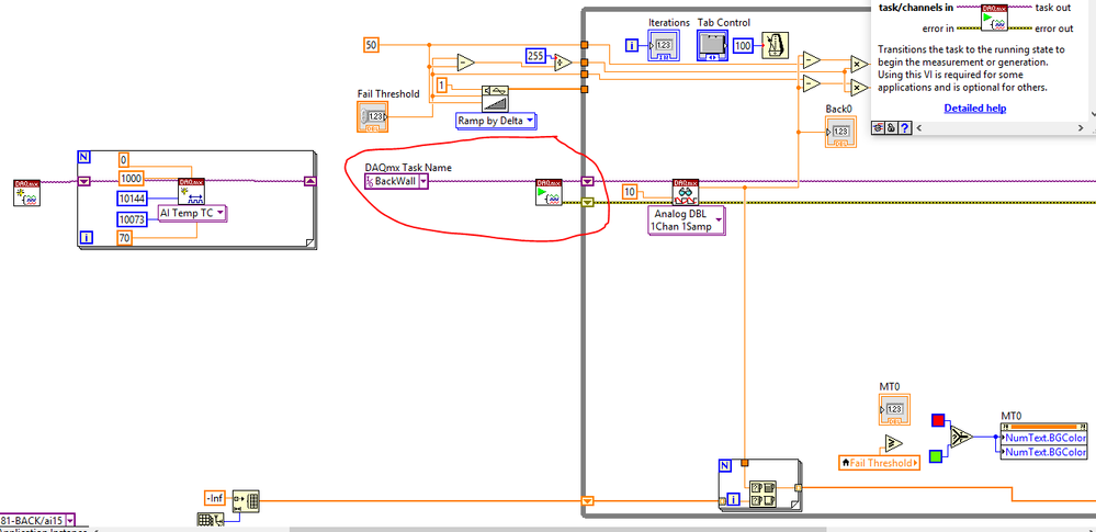

Thanks, I'll start working on what you've described. I do want to get this working for one task at a time, especially when it comes to all the indicators and color change stuff on the front panel.
Do you think I should try and put the indicator color changing code in a subVI? Maybe that will make it easier to duplicate 64 times for each channel.
I think I do have these tasks saved in MAX correctly and I don't expect channel configuration to change. How do I use them directly in LV?
I just set this up based on "help" in LV

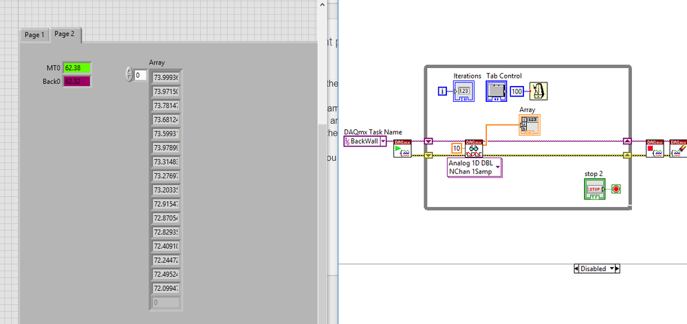

Like this?
Message 12 of 33
(1,383 Views)
Yep, that should work.  If the task is already created and configured, there is no need to re-create it in your block diagram.
Next, change your DAQmx read function to "multiple channels, one sample".  In this mode, it will output an array of data with the same length and order as the channels contained inside the task.  If there's any question about what order that is, you can feed the task wire into a property node and retrieve the list of channels (which you can then convert to strings and use in your display, if desired).
Start by simply sending that data array to an indicator, to verify that you can see all 16(?) channels from that task.  If that works, we'll go to the next step.

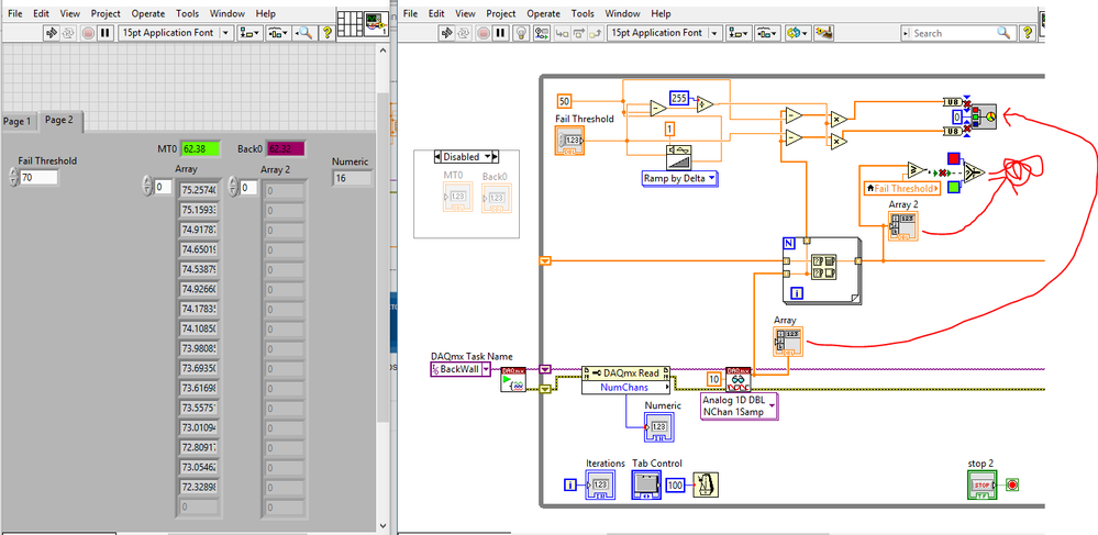

I want to get the min/max for each channel and show the max statically through the duration of the VI execution. I also want to show the current temperature of each channel as well as the max it had reached.
After messing around with the array indicators and bg colors it looks like I'm going to have to index the arrays into individual indicators to get the colors to change independently from each other?
Message 19 of 33
(1,341 Views)
@neesea
Here's where I'm kind of stuck. I can't seem to find out where to set the numeric bg color for the arrays.
