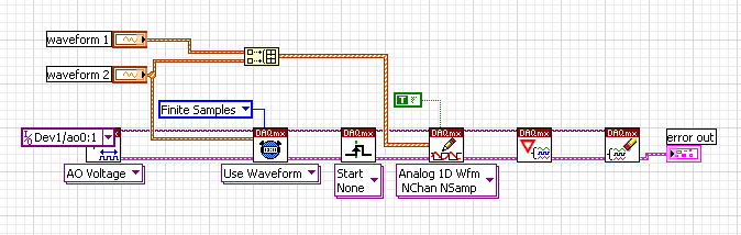

It sounds like the most straightforward way would be to create two waveforms, both 800 s long. The first would have 400 cycles at 2 s each, and the second waveform would have 1 cycle at 800 s. Create an array of those waveforms and wire that array to the 1D Wfm NChan NSamp version of DAQmx Write. The two waveforms would have to have the same number of samples.  That's a bit inefficient, but I think it should work.
