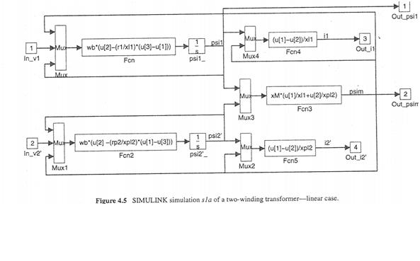

Good Morning:

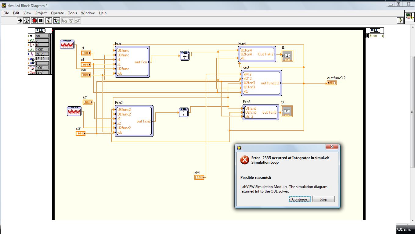

I'm making a Simulation to the Transformer in the Linear Case, The Diagram of Blocks that i used is a Diagrarm to make it in Simulink But i want to make this in Control Design and simulation, apparently is the same way but, i have error in my Simulation, where is it?   I checked Subdiagram by Subdiagram but i don't found the error, might you help me please?.
After of that, i want to make a saturation in the signal but i don't know hI checked Subdiagram by Subdiagram but i don't found the error, might you help me please?.
After of that, i want to make a saturation in the signal but i don't know how,
attached file (file subsystems and general) in addition to the block diagram format. doc, The Diagram belong to The book:
Dynamic Simulations of Electric Machinery: Using MATLAB/SIMULINK
Chee-Mun Ong
