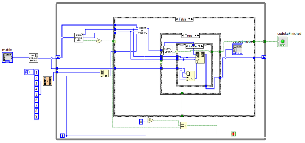

I also tried to randomize the insertion of the numbers in the array. Actually, it seems to work, but not always: as more the numbers in the input matrix are, the probability of generating a infinite loop increases... maybe it's the algorithm?
Also, the final result is only shown in the output matrix of sudokuInsertIfPossible.vi, but in Main.vi I can see only the output matrix of the first call of solveSudoku.vi.

You mean you are Replacing Array Subset.  Insert into Array is a completely different function that causes an array to grow.
I'm certain it would be the algorithm.  Solving Sudoku puzzles is pretty complicated.  It seems like it would require more code than you show here, but I can't see what is going on in the subVI's.
Would you really need recursion?  I think it would be a case of continually iterating over the puzzle, trying to solve more blocks as you discover more answers.

I think this would be much more difficult without recursion. The algorithm relies on going back in time if the chosen number doesn’t provide a solution.
Since I couldn’t open the project, I created my own version of it, following the C code provided in the link. It does in fact work. I’ll post the code when I’m back at my computer.
