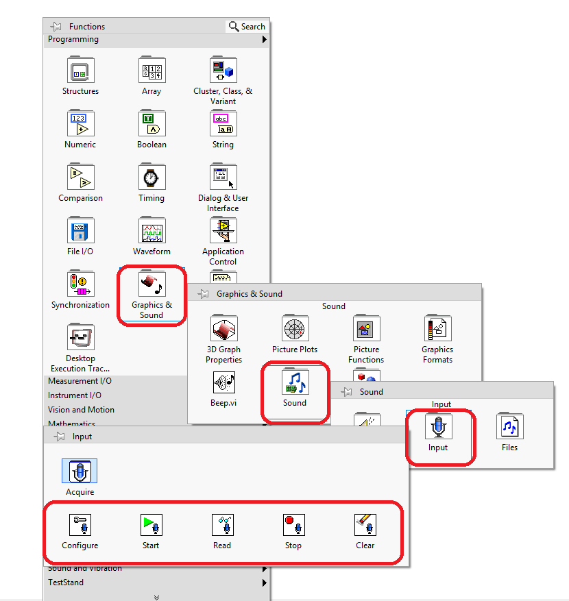

Data acquisition:
To acquire the data we need to access our sound card. It should normally be fine to use the following palette:
I would recommend to use the highlighted chain and not the Aqcuire.vi
This is mainly due to processing overhead on express VI's and it is also good practice.

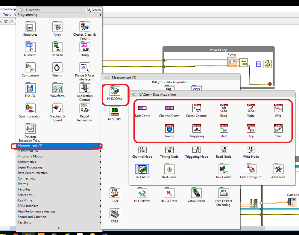

Data Visualisation:
Lastly we want to display our processed information.
In this case it would be controlling the LED.
For this I would recommend the DAQmx API.
With this you can easily set the output states of your device to represent the data you processed in the previous step.
