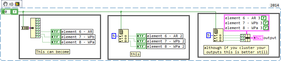

Mostly you are just encountering the same problems with having a large number of indicators that everyone else has, ideally grouping the related indicators into clusters should make things much easier to read and program.
With regards to the unbundle array and multiple subarrays you can just use the resizable aspect to allow access to multiple different values without having multiple instances of the tool.
[EDIT] Pretty much what ravens said, just with slower typing and snippets.
[EDIT 2.0] Fixed missing values for indexing 2D arrays
(5,211 Views)

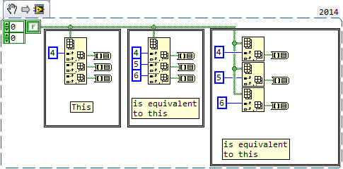

@ogk.nz wrote:
Actually the right most is NOT equivalent to the other two.  It will give you row 4, row 0, row 0.  It would need the 5 and 6 constants wired into the other Index Array functions to be the equivalent.
(5,201 Views)
This is what I get for trying to copy paste early in the morning

That is fantastic advice thanks you very much. I was aware of bundles had just completely forgotten about them.
