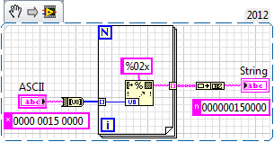

I am having a hard time getting the program to do what I need it to.  What I need is to take an input that is in Hex format (eg. 00 00 00 15 00) and make it read the same value as a Decimal with out changing the value (eg. 0000001500).
Could someone please help me figure out how to do this?

Like this? or did you need that scaned into a integer?

That was exactly what I needed.  Thank you for the help.
