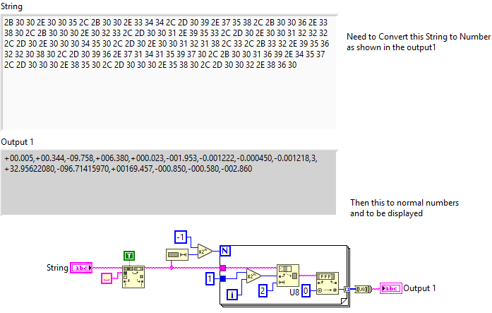

Hello Sir,
I have attached a VI showing the string that needs to be converted

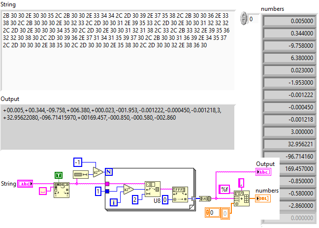

Here's the part containing numbers. Not sure about the header, which contains non-printable characters.

And of course get them into a numeric array as before using "spreadsheet string to array" with comma as delimiter:

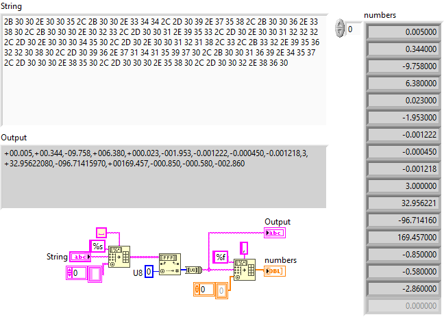

Of course if you can guarantee that the string is well-formed (i.e. 2 digits 0..F separated by single spaces, etc.), you can even do it loop-free, of course. Same result. 😄

Here's the last one in LV13
