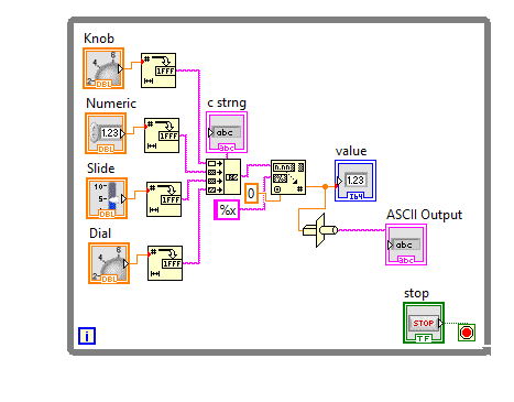

This is what i am trying to do sir

Try to understand my code and you'll immediately notice that your code makes no sense. Hex format is only defined for integers. Also, casting gives you a generic string. ASCII defines mapping of bytes to characters, irrelevant here. What defines your loop rate?

Here Loop rate is not defined sir it keeps on running untill i press stop i did this because i want to change the values while code is running

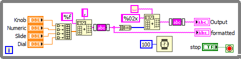

What Altenbach is saying is that you have a CPU burner of a loop there.  It will run as fast as the CPU allows it.
Put a small wait statement in there and you won't hear the fan in your PC spin up super high trying to keep your CPU cool.

Here is one possibility. You probably need to adjust the first format (current %f) to something that gives you the right number of significant digits. I don't know the specs.
Still, that entire communication seems very convoluted. What were these guys thinking!
