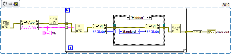

One approach would be to have a VI which you run manually after an abort, which iterates through all VIs in memory and sets the Front Panel state to Standard if it is currently set to Hidden.

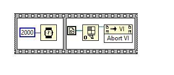

Perhaps this is helpful to you. I have two Vi's - Time.vi and Observer.vi
The Test.vi:

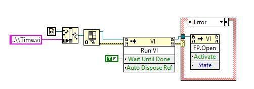

And the Observer.vi:
I hope I understood what you want to do. I run the Time.vi from Observer.vi and if the Time.vi is aborted, an error is thrown, at which point you can open the front panel of Time.vi.
So perhaps you can run a loop that observes the vi in question, since open vi is a reference to vi on disk somewhere. I hope it helps.
