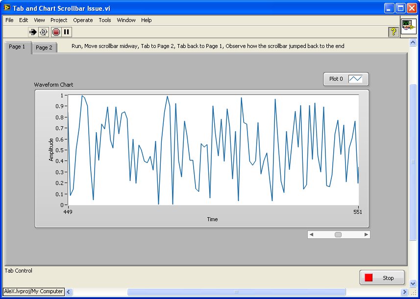

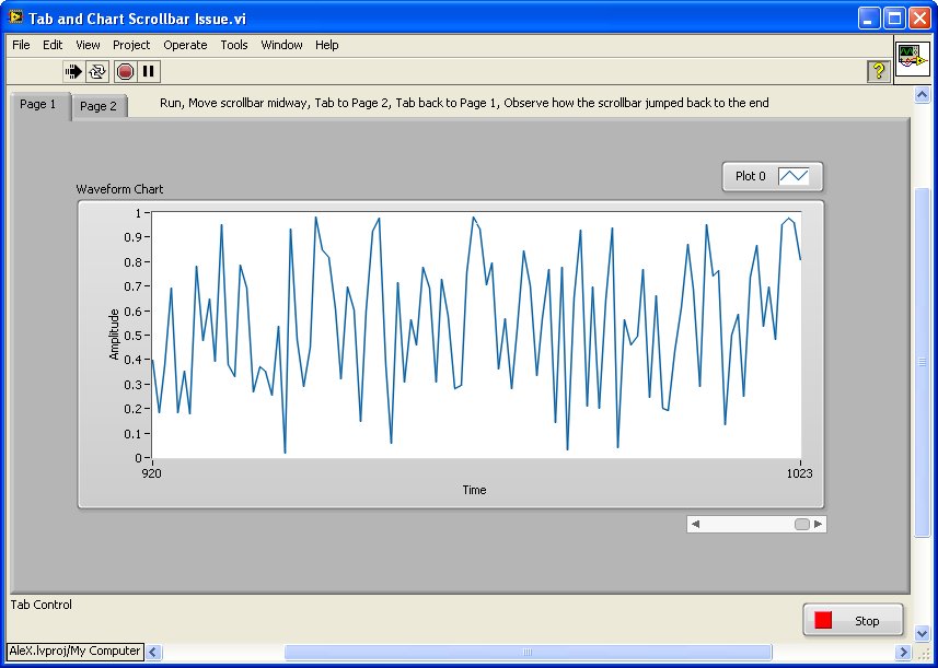

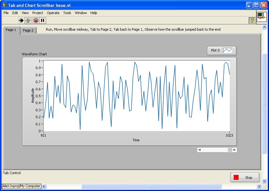

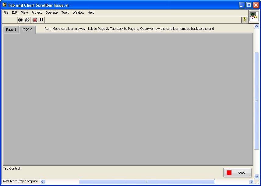

I am using the latest patched SP1 LV 2013 version on Windows XP 32 bit.
I can't watch that video.
Here is what happens:
Step 1: Run
Step 2: Move the scrollbar mid range
Step 3: Tab to Page 2
Step 4: Tab back to Page 1
Observe how the scrollbar (and graph) has snapped back to the end of the range.
This is a bug by any other name and that is a VERY ANNOYING one when you design an interface.
