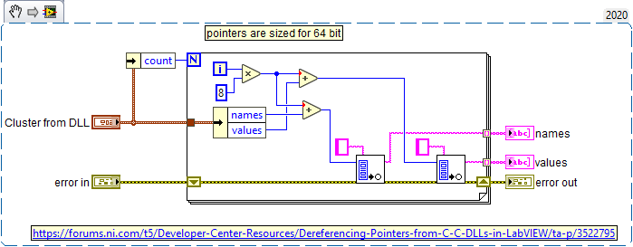

What problems do you run into? LabVIEW will not create string arrays by itself from that cluster if that is what you are asking.
You can model the struct as a cluster of two u64 (or u32 for 32 bit) and an i32. Pass it to your DLL, and you get the pointers to each first char* back.
Then you copy the data using GetValueByPointer or MoveBlock.
This is a good resource about dereferencing pointers from within LabVIEW: Dereferencing Pointers from C/C++ DLLs in LabVIEW
GetValueByPointer is located here: <LabVIEW>\vi.lib\Utility\importsl\GetValueByPointer\GetValueByPointer.xnode
This will probably work:
dereferencing char**dereferencing char**
Since you have control over the DLL, you could also create a more LabVIEW-friendly interface. Although in this case writing that interface is more work, so I won't go into detail.
