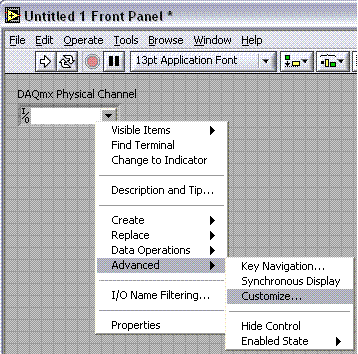

Is there any way to customize DAQmx controls because "Customize Control" option is disabled and greyed when a DAQmx control is selected.
Just like dialog Controls, can we customize DAQmx controls in such a way that they are shown according to the Windows theme.

You should be able to just right-click on the control and follow the tree as you can see below:
If this isn't available for you, then could you tell us what version of DAQmx and LabVIEW you have?

Thanks Otis,  its working now but I used the same method previously but CUSTOMIZE option was grey in both edit menu and in advance short cut menu. I'm using LabView 7.1 and NI-DAQmx Version 7.4. But now it is customizeable.

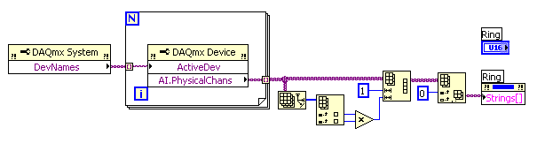

Unfortunately there is no easy way to convert the DAQmx controls to the Dialog controls.  There is some code behind these controls that is run when you put them down (thus why they take a little bit of time to be placed).  However, there are several solutions that I might suggest.  The first and easiest would be to use a dialog string control instead of the DAQmx control.  The DAQmx VIs will treat these exactly as if you were wiring a selected task constant (or the like), but everything must be spelled correctly.  This obviously not the best solution.  The other would be to use the dialog ring control and populate the string list using the appropriate property nodes (see below for the physical channels).
This is a fairly dirty solution and some formatting will probably need to be done, but this should give a good idea of how to do this.

Thanks Andy, I have used the same dirty technique to implement that idea.
