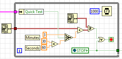

So I implemented a timestamp approach rather than a wait approach, which I agree is a more robust and accurate coding methodology for long periods. Using this approach possibly introduces a little more overhead but it is not accumulating error on each iteration of the wait(ms) function like my previous code. Here is what I ultimately ended up using:
However, I realized that this wasn't the main bug that I was experiencing...there was a tiny little boolean in a error handling sub-vi that was set incorrectly, breaking out of the configure-equipment state-machine, rather than continuing to monitor the device until it had stabilized and soaked. This was in turn causing the dwell timer to start prematurely...hence randomly short dwell times every time there was a communication error with the device.
...now I just need to figure out why there are so many communication errors... 😉
