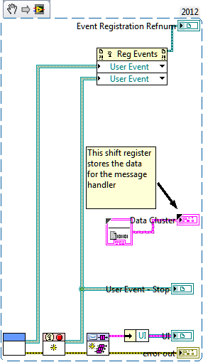

Instead of having the Register Events in the "Create Methods" you could do that part outside your "create" SubVIs and then simply bundle them. Then you create your individual User Event handling. See snippet where i created a "Create User Event - Update" vi in front of the Stop.
