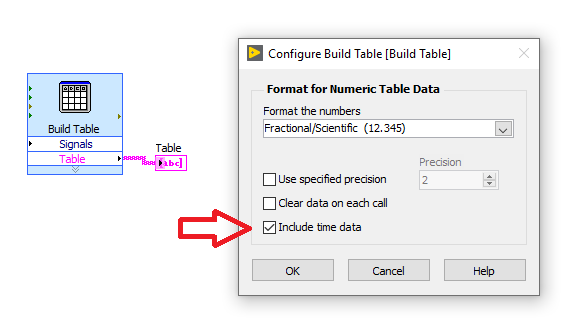

@Zaqf wrote:
I just need a time column in my express table
Are you saying this checkbox does not work for you?

This actually works buh I'm getting the date and month , not the accurate second at which the temperature is recorded .
You can right-click the express VI and "open front panel". Now change the time format from %c to something you like better and save under a new name.
(Since it is re-entrant, use ctrl+m to edit. time format code can be found in the help).
Still, I would get rid of the express VI and use "real" code instead. 😄

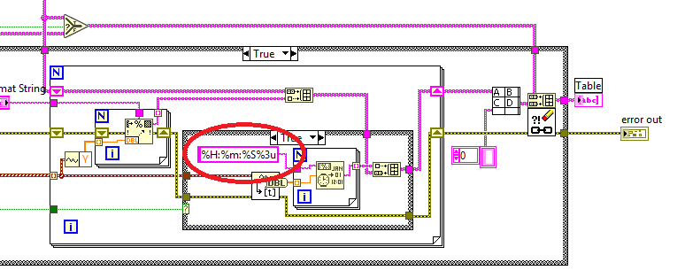

I've attached the pic . I just wanna change the date to exactly time In seconds.
Message 17 of 59
(1,455 Views)
Your option are as have been highlighted:
  1. Move away from the Express (blue) VIs, and generate an array of time values then add those to your table (this is the much better option!!)
  2. Modify the Express VI (that specific instance, not all Express VIs of that type) by:
    1. Right click on Exp VI for Build Table - choose Open Front Panel
    2. Click convert
    3. Open the yellow item in the newly created VI
    4. You should now be looking at "subBuildTable.vi"
    5. Choose "Change to Edit Mode" from the Operate menu
    6. Click File > Save As, choose "Substitute Copy for Original"
    7. Double click on the ".." at the top of the dialog that pops up. You'll end up with a normal file dialog
    8. Go to where you want to save the VI, save the VI
    9. Open this new VI, directly from your project view (you are using a project, right? 😄 )
    10. Change the %c in the middle to a different format string, for example "%H:%m:%S%3u" which gives hours:minutes:seconds.3decimals. Read about the possible timestamp format specifiers using the "Help" option when right clicking on the node to which it is attached and choosing the hyperlink at the bottom labelled "Time Format Codes".

I don't see the %c . Where is it?
