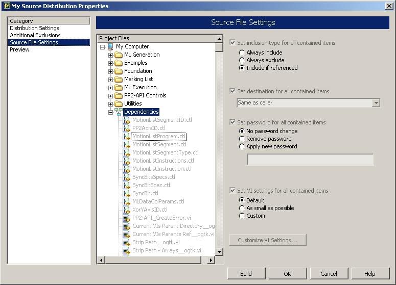

There are hundreds of them and they are greyed out like always.  But here is an image with dependencies refreshed.

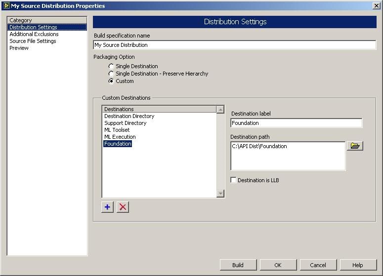

This is set to "single distribution - custom".  I am not preserving hierarchies.  See below:
Any of the folders in my project can be added to any custom destination.  See below:
But as soon as I click on "dependencies" the option to select the destination gets grayed out and is stuck at the defaul of "Same as caller".  This puts hundreds of low level vi's in the same directoriy as the caller.  So if I do a source distribution of one vi with 100 dependencies, I get a folder with 101 vi's in it.  I can't set the dependencies to a different folder.  Use labview 8.20 to recreate the problem.
