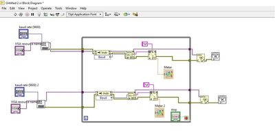

Hi, I have some problems with connecting Arduinos in one project. They send information via com-port and labview processing it, now it's two potentiometers. When I connect one it works propertly, but when I connect second it crashes or works on of them... Maybe somebody know how to fix it?

How do you have them connected?
Also why are you using baud rate setting to read buffer?

I don't know your VISA settings because you only provided block diagram image, but your baud controls are both named as 9600, while one of your arduinos uses 4800 and the other 9600.

I'm choosing mannually baud rate. Maybe you have some working example with two or more arduinos?

Reading two devices in one loop this way is problematic.
Unless two devices are trigged by the same event (or are sharing the same clock, which is unlikely (but maybe not impossible) with two arduinos) the two devices are asynchronic devices. The times their data is pushed will eventually start to shift phase.
After hours, maybe even days, one device's data will not be read fast enough (as the read waits for the other device). It will return old data, until eventually the serial buffer overflows.
It's asking for problems, IMHO.
Read in two loops, or pull data by doing a write and read (requesting the data).

Good, you are using the Serial.Println.  So this function appends a Line Feed (I don't remember if a Carriage Return is also appended).  This is what we call a Termination Character.  Even better, it is the default from the VISA Configure Serial Port.  So all you need to do is wire up the correct baud rates for each port.  Every other setting should work.  Now when you read, you just simple tell the VISA Read to read more bytes than you ever expect in a message.  In this exact case, I would probably use 50 (no way a single value should be printing 50 characters).  You do this since the VISA Read will stop reading when any of the following occur: 1) the desired number of bytes are read, 2) the termination character is read, 3) the read times out.  So by setting the bytes to read to be more than a single message should ever be, we are then relying on the termination character to stop the read.  This ensures you are getting a complete message.
I would also follow the advice of making a loop for each Arduino.  I almost always put streams each in their own loop.  This way, if one goes down it won't mess up the other.
