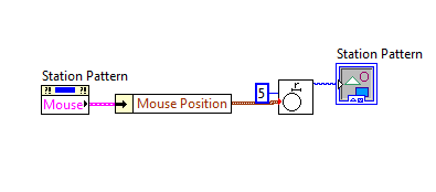

I tend to use the Mouse property of the picture control to get the position.  Deals with things like the origin shift for you.

Thanks, the Mouse Position property does exactly what I need.
