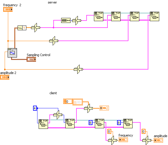

This convertions are necessary because I´m communicating two(or more) computers and the vi´s only read string data type, so because this I´m using type cast to convert an array string data to an array numeric data. The input of signals (the waveform, the frequency and the amplitude) is concatanated strings. I attach for you the vi that I said. I´m using two vi´s (Server vi and Client vi). The Server generate the signal and the Client display them. Both vi´s I see in Find Examples and I did some modifications.

So the first VI you posted was supposed to simulate both the client and server? If that's the case, after you type cast something to a string, you would have to type cast the string back to the original data type and you weren't doing that. Your dta was just binary garbage without doing that. Here's something that should work and is a bit closer to the actual shipping examples. The length of the array is type cast to a string and written, the type cast array is then written. The frequency and amplitude are then each type cast and written separately. In the client, the length of the array is first read and that determines the number of bytes to read for the data array. Two separate reads follow that to get the frequency and amplitude. Each are type cast spearately back to dbl.

Put the type cast functions outside the for loop and replace the single TCP/IP Write that is inside with the separte ones for each data item.
