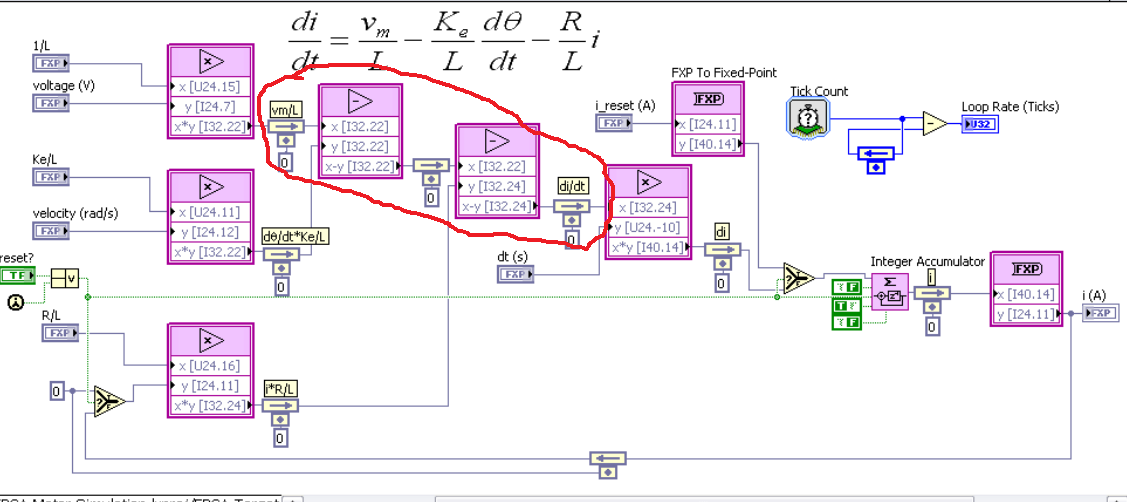

Actually, I was doing pipelining acc. to this picture and idea from developer guide
I am not still sure about using high throughput math as it is in the example. How it can halp me or not ? I was said that HTM block should not be used but in all manuals it is writen that HTM block are faster and take less resources...

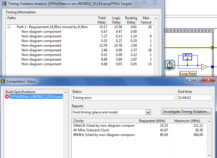

I tried to remove all feedback nodes for pipelining and after compilation I got this message :
LabVIEW FPGA:  The compilation failed due to timing violations.
I suppose it is because pipelining is missing. Am I right ?

Pipelining is one way to resolve timing constraints, but it is not the only solution.  Is the code that's causing the problem inside a single-cycle loop?  If so, you could take that code out of a single-cycle loop and let the compiler figure it out; it will cost you more FPGA resources and you won't have as much control over timing, but that might be fine so long as it still compiles succesfully.  You can also attempt to simplify the logic or reduce the precision of the fixed-point values.
If you don't know that you need the high-throughput math functions, then you probably do not need them.  They're useful for very-high-speed computations, and it looks to me like you're not that concerned about exactly how many ticks your algorithm uses.
