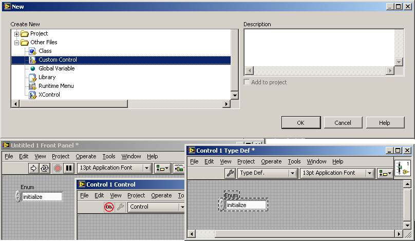

Take your enumerator.  If it is not a control (ie constant), change it to a control.
Under File Menu, select New > Custom Control.
Move (or copy) your Enum Control to the Custom Control.  Change the Control to Strict Type Def (the selection to the right of the wrench).  Save it.
(EDIT: ** OOps, the picture shows the wrong one.. sorry**)
Copy that new Strict Type Def control to your code.
See images below.
OR.. If you're using LV8.x, and using a project, I would recomment that you do it from within your project explorer.  Simply insert a new "Control".  The rest of the steps are similar, except that you can insert it from your project.
R
