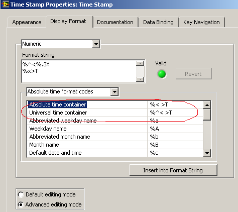

If the problem is "how do I am make the timestamp control display UTC?", that is best done via a custom format: use the %^<>T container in "display properties":
Non-obviously, this setting applies to constants also. If you set a constant using the default (localtime) view, then quit LV, change your timezone, and restart, the constant will appear to change. It hasn't really changed, in that the underlying number-of-seconds-since-1904 is still the same, it's just displaying it differently. (It would be nice if LabView gave us some kind of visual to indicate whether a control/indicator/timestamp is showing local or universal time.)
