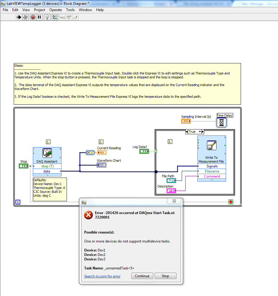

I am looking to measure the temperature profile of a rod using multiple NI USB-TC01 at points along the rod. I want to use the LabVIEW provided VI, LabVIEWTempLogger, which is capable logging the temperature and exporting it to an excel file. My issue is adding multiple channels in the DAQ Assistant for each TC01 being used. When I start the VI, i receive error 201426 (one or more devices do not support multidevice tasks). I am not very experienced in LabVIEW but have been told that you can use up to 4 TC01 using the single provided program. I would appreciate any recommendations to change to the current VI that I have or if someone could provide me a VI that would resolve this issue.

Since they are separate devices and you are taking one sample at a time, try a assistant for each device.
