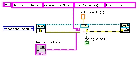

Sure, I'll provide a pared down example that demonstrates my use-case:
I have a control to the VI that takes in a 2D array of strings representing the data I want printed in a table.  I am generating a standard report, adding a table to the report, and printing it.  The first VI is "New Report.vi", the second VI is "Append Table to Report.vi", and the third is "Print Report.vi", all found standard in the Report Generation palette.
Note that the "Append Table to Report.vi" has an input parameter "Column Width" with a default value of (1).  This input parameter is a single input parameter, which defines the column widths of ALL the columns in my table - hence, with the VI the way it is, all my columns will be 1 inch wide.
I find myself needing to be able to define per-column widths, not just a single global column width parameter.
The only way I have found to do this is by using an Excel template file.  The "New Report.vi" takes in a "template" parameter, and if used, the report generation toolkit can be set to ignore the "Column Width" input parameter on the "Append Table to Report.vi" by setting the width value to -1.  Instead it will launch Excel, open the template file provided, build the table using the template, will close Excel, and will attach the generated table to the report.  However, I have a strict requirement that Microsoft Office NOT be required to be installed on the computer.
So, without using Excel, is there a way to generate a table in a report and define the width of each column individually?
-Danny
