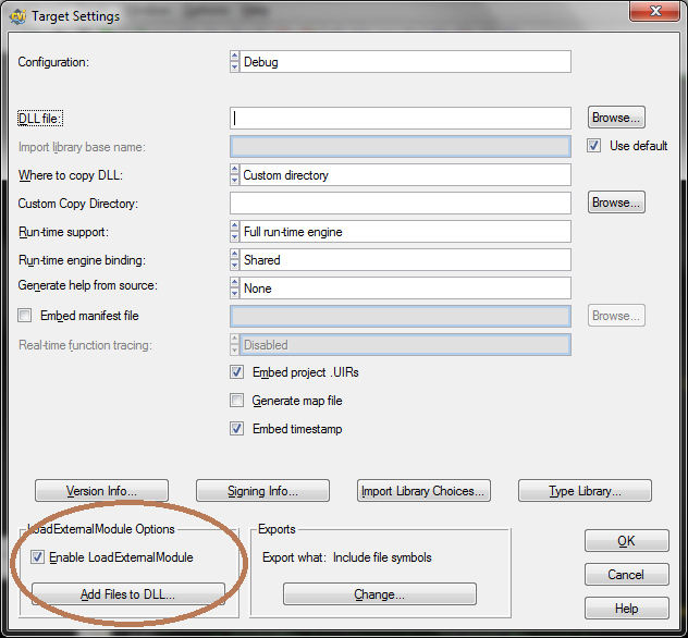

Use LoadPanelEx instead of LoadPanel.
And enable this in the setup:
