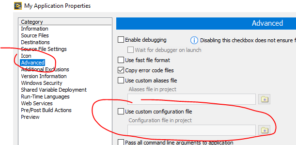

You can use app dir constant
or change file name in builder settings
Not quite sure the intent is to use a custom LabVIEW config.
