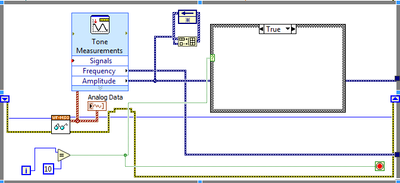

I would like to be able to take 10 readings of my voltmeter and then take an average of those. I just don't know how you store those 10 readings and then parse them. I suppose I need to build an array but not sure what that would look like.
This is what I have so far.

I don't understand what you are doing with the blue dynamic datatype wire when you are building them into an array of dynamics, and feeding it to a shift register which doesn't seem to go anywhere from the left hand side of the loop.
Message 2 of 14
(3,255 Views)
Well I guess I don't understand the dynamic data data type. I really just want to build one of floats. The shift register is confusing sorry, it is actually the instrument handle for the voltmeter.
Ahh yes.  The wires that overlaid each other confused me as to what goes where.
As for the dynamic datatype, most people don't understand it.  It was this magic wire NI created that allowed anything to connect to anything, and hid the details underneath.  The problem is that it hid the details so you it is hard to figure out if it is doing what you truly want it to do.
Since you are feeding back and building them into an array, but then doing nothing with that, you might as well get rid of the feedback node and build array.

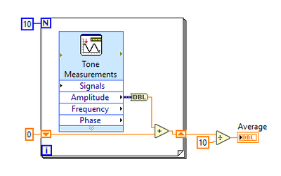

You don't need to store those 10 measurements. Just have a shift register, and keep adding the measurements until you get to 10. Then outside the loop divide by 10 and you have your Average. Like this
That's a Rube Goldberg  "pseudo-FOR loop" (fixed number of iterations known before the loop starts).
Have you actually tested this? Shouldn't the shift register be initialized in some way?

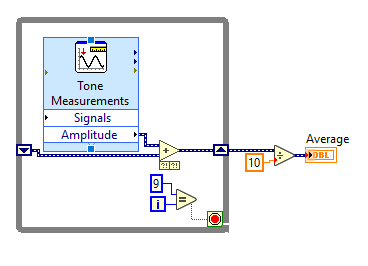

@altenbach wrote:
You are correct, it was more of a mini example thrown together. If you wanted it to be proper you could just do it like this
