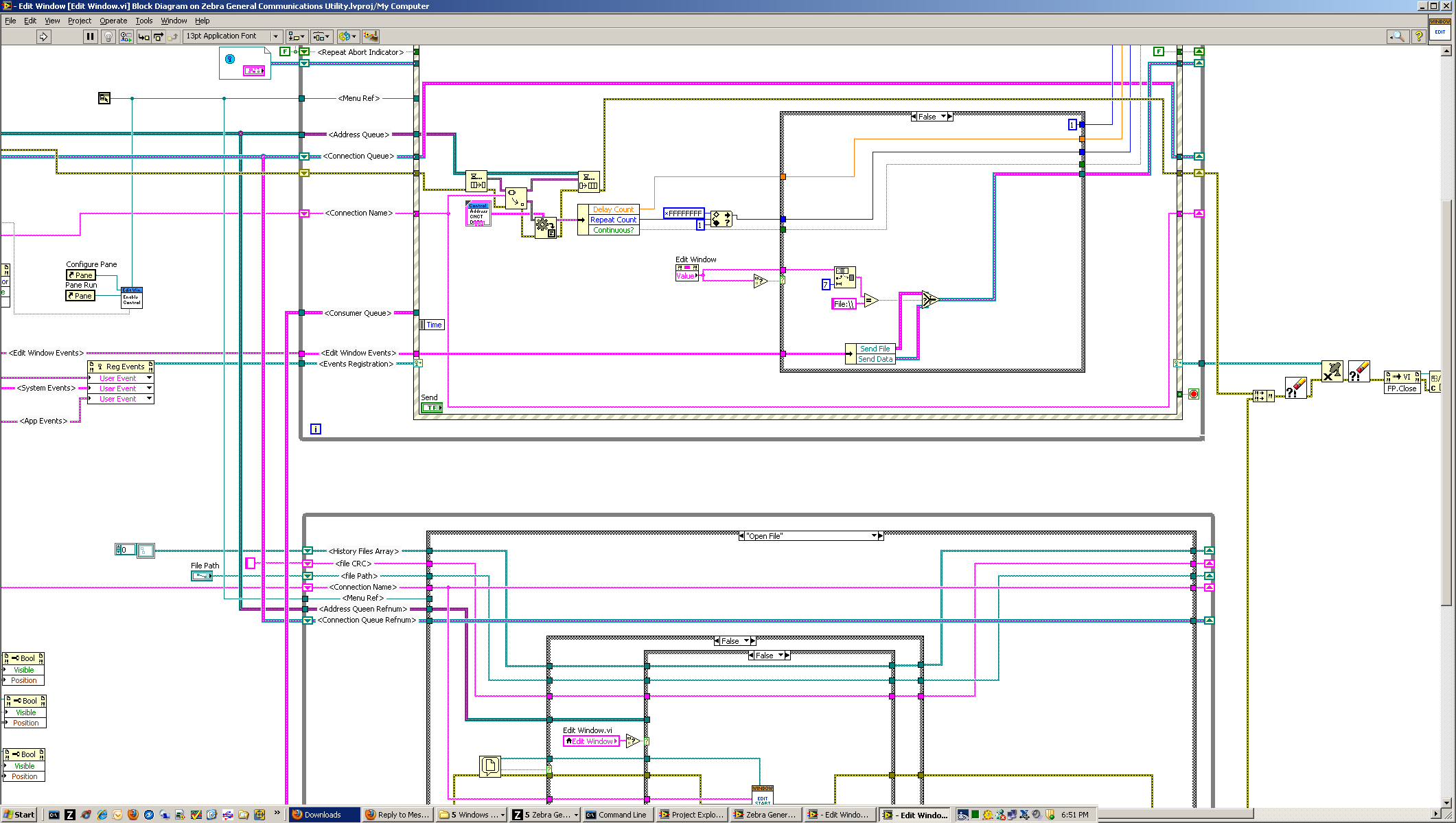

What part of this massive code is giving you the problem? This really doesn't look like you took any of our advice to heart. This is still one massive block diagram with all of the code running in a single while loop.
Here is a picture of a fairly typical, well architected piece of code. While it doesn't quite fit on a single screen any single section of teh code can be. This is one of the larger block diagrams we have. Most will easily fit on a single screen.
Notice that this code is east to read and follow. It ises multiple while loops. This is a typical producer/consumer design pattern. It is also one part of a much larger application.
