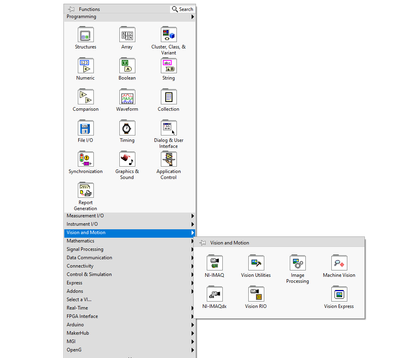

I have an inspection code in NI vision builder. I want to show this code as a camera view in the interface I created in labview. I found a few methods, but there are cases that I can't solve. I wanted to try the method given in the link, but I cannot see the Vision Builder AI toolbox in vision and motion. I installed all the necessary drivers and programs, I reinstalled VBAI with all its drivers, it still doesn't seem to be installed. I don't understand what the problem is, I don't know if it's related to the version I'm using. I'm using Labview 2021(32-bit) and VBAI 2020(32-bit).
Are there any other methods related to this issue? What I want to do is to integrate the vbai inspection image into the interface I designed and show it on the front panel, as shown in the link. I would be grateful if you could help.

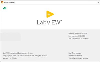

Hello. Which version of LabVIEW do you use?
(2,732 Views)
Hi, I already wrote in the post, Labview v21.0(32bit), NI vision builder 2020(32bit)
(2,728 Views)
You have different versions of LabVIEW and NI Vision Builder. The versions should be the same.
(2,723 Views)
Thank you for the answer,
I've thought about this issue, but since I'm using the latest version, I didn't think that the problem could be caused by this. When I searched the internet it just said that the working bits must be the same. But I'll try again by installing v20, thanks a lot.🖐
