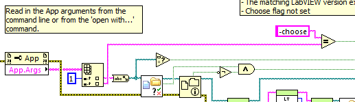

Passing command line parameters into a LabVIEW application is actually fairly straightforward.
There are 2 things you need to do:
- Modify the LabVIEW exe build specification to pass all command line arguments to application
- Read the App.Args property which returns an array of strings for the parameters - the first parameter is always LabVIEW.exe.
For an example:
Here I read the arguments, ignore the LabVIEW.exe and then read a file path as the first argument and check it exists and there's also an optional "-choose" parameter which determines whether or not to show the UI.
Information is here: http://digital.ni.com/public.nsf/allkb/17C3AD70493CE0208625666A00763364
(blog)
(4,664 Views)
Thank you very much! It worked very well!
