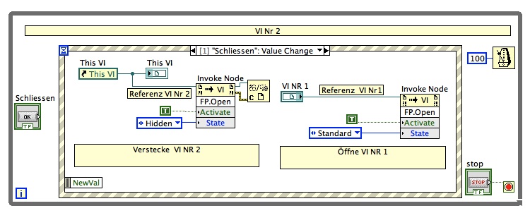

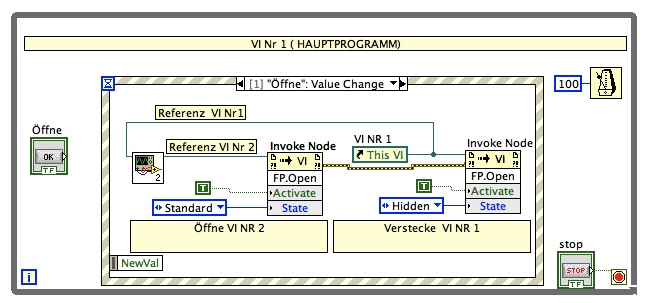

I've almost the same problem. I have a Main VI that I open. Then I want to press a button and open a VI 2 (The Main VI should hide). When I close the VI 2, the Main VI should appear again. So there is always only one window visible.
I've tried it but the problem is, that when I go back to the main VI, it's like frozen. It looks like its deactivated.
Here are pictures of both the Main VI and the VI 2 (the code files are attached also)
Does anyone have an idea what the problem is??

There are several things wrong with your VIs the most important is that you aren't using data flow.  I'd recommend some free LabVIEW training:
3 Hour Introduction http://www.ni.com/white-paper/5243/en/
6 Hour Introduction http://www.ni.com/white-paper/5241/en/
LabVEW Basics http://www.ni.com/gettingstarted/labviewbasics/
Self Paced training for students http://www.ni.com/academic/students/learn/
Self Paced training beginner to advanced, SSP Required http://sine.ni.com/myni/self-paced-training/app/main.xhtml
LabVIEW Wiki on Training http://labviewwiki.org/LabVIEW_tutorial#External_Links
Attached is a zip with VIs that I think does what you want.  Run the main and then click the button to show the second window.  Then close it (or hit stop) to close it and show the main again.  From there you can close the main to stop, or click open again to re-open it.
