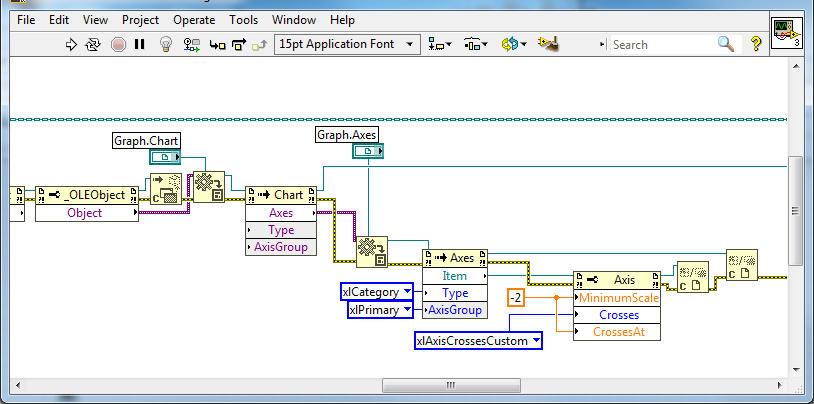

1. The embedded chart inserted by the RGT is not an Excel object but an MsGraph object. The MsGraph chart has a very limited color palette (56 values). You can select any RGB value but MsGraph will match it to the closest of its existing palette value (in some case to a grayscale). You can see these colors if you activate a chart, right click it and select Format Chart Area (not sure about the actual English name my excel is not in English).
2. You can access axis properties and method with the Chart Axes method, see below.
Ben64

Thank you aputman. I looked at your example, but I cannot find Excel.Chart object. I put a property note on the block diagram, and right-clicked on the Property -> Select Class -> ActiveX -> and here I don't see Excel._Chart, I only see Excel._OLEObject, Graph.Chart, etc. but not Excel.Chart. Anyway, I have Labview 2011. Is this the reason? Or is Graph.Chart the same as Excel.Chart?

Thanks Ben.
What is the procedure for creating a Graph.Axes object from scratch so I that I can connect it to the Variant to Data type input?
