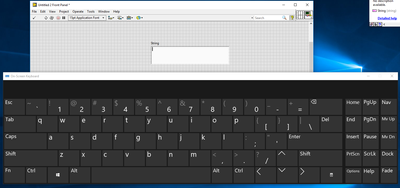

In my case the cursor is not seen in the string control. I am attaching an image for reference

In your picture, your front-most window is the On-Screen Keyboard and not the VI. The VI needs to be the front-most window for you to be able to key focus on any control in it.
