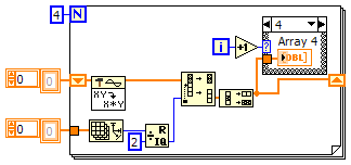

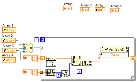

Thereare many ways to do this. In the example below use the increment to increment through the different cases. add a case for ever indicator that you what to use. The next way would be make an array of the references of the controls and send them through the loop.
17587iC19EE8F5A3AF1D26
In this example you jus thave to add references to the array in the order that you want them updated.
17589iBE1B298DC909B89C

I recommend against the 2nd method.  Property nodes are awfully slow.

It really depends on what you are trying to do. The second method is much easier to expand and take care of but it will be slower. If you are only going to run four iterations then it is not a problem unless you are dropping it into a loop that is constantly processing data. If you are post processing data and you do not care about milisecond timming then you should be ok with the second method.
The first method is harder to take care of but it should be the fastest way for you to get where you were asking to go.
