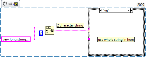

Branch the string wire and insert a "String Subset" function before the case structure's condition terminal:
17659iC704330E6CF8F99A
Shaun
