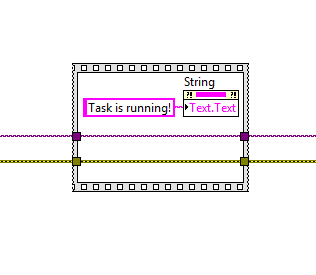

You could use something like this, to ensure that at some specific point in your code a string indicator on the front panel is updated.  After placing the string indicator, right click on it go to Create>>Proprety Node>>Text>>Text.  The string indicator will update to the input of this property node when this sequence structure is reached.  Does that help?

I see what you mean. Problem seems to be that if the sequence panel is before the AD In.VI it will update while it is waiting for the trigger.  If I put it after the .vi it updates after the data has been collected.  So, the message stays on "Waiting for trigger.." before and during the data collection then changes to "Collecting Data" just before the graphs are updated.
I need a property node that signals that the collection process is underway or has been triggered.
