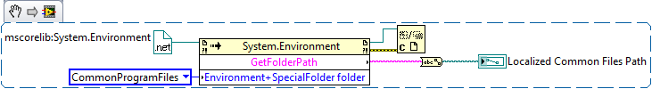

I would query Windows to find out the current "CommonProgramFiles" path (i.e. C:\Program Files\Common Files) and copythe file at runtime.
The way that I find out special folder paths like this is to make the following .NET call to System.Environment.GetFolderPath:
Shaun

I tried shew2's .NET solution and it seemed to work until I built the installer and tried it on a target machine. The executable ended up with a broken run arrow with no explanation. It may very well be that I have not included something that is necessary for the .NET, but I suspect the registry VI solution would be easier to contend with.
In the end, however, I've decided just to put the DSN file with the application instead of the Common Files folder thereby avoiding the whole localization issue of the Common Files folder.
Thanks to you both for answering so quickly with great ideas!
