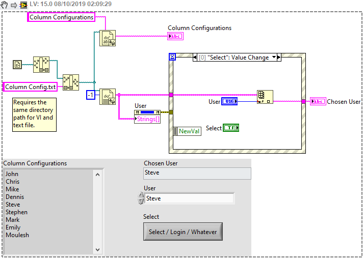

Here I used a node that returns the Current VI's Path, then Strip Path (to get the directory) and Build Path (to add the txt file name) to create the path you need for the file, when the VI and txt file are in the same directory.

Assuming the above to be true (re selecting a user) here's an example/solution that might help:
  • First I get the names as a 1D Array by right clicking the Read function and choosing "Read Lines".
  • Then, I pass this array of strings into the "Strings []" property of a Text Ring. This is a numeric control with a set of strings associated.
  • I use the error out wire to ensure the strings are populated before the Event Structure can start
  • I set the Event Structure to only process the "Select" button value change (i.e. when I click the Select/Login/Whatever button). (See the linked document for more details).
  • I index the array of strings with the value of the text ring to get the currently selected name

If you change that Text Ring into a ComboBox, you do not need the Index Array.  The value of the ComboBox is the selected string.  So just save yourself a step.

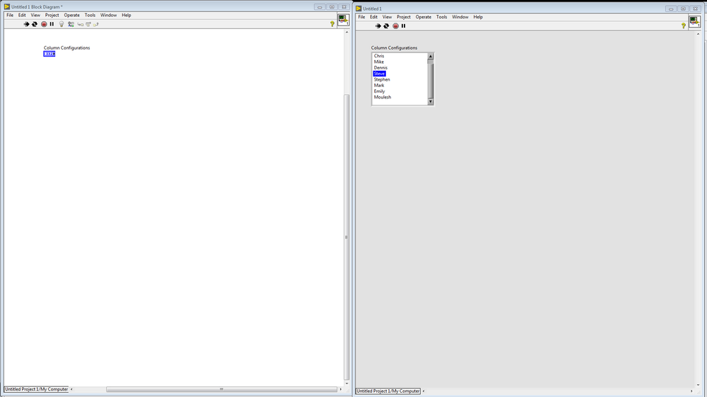

To answer your question "Do you mean you'd like to perhaps populate a dropdown list, then choose only a specific name (as a string) to use later on in the VI?" Yes, sort of.
The image below is what I am trying to do, but in the image I used a listbox just for you to have an idea of what I want. Notice how the VI is running and the name Steve is selected just by clicking once on the name "Steve".This is exactly what I want. But I want to do it using "read from text file" block or similar block that prompts the user to use a file. The VI that you sent is good and I think you understood what I want but if you can just help me select a name by clicking "once" on the name from list without clicking the select button, then you'd solve my problem.
You are on the right track.
Thank you for your help.
I have attached the VI for the image.

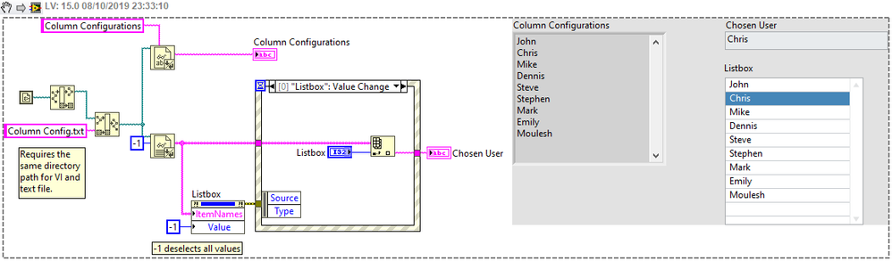

Then as you found, you can use a Listbox.
Here I set the Value to -1 before the Event Structure starts (to deselect), then check for a Value Change event on the listbox (instead of using a Select button).
The same is possible with the Ring I used previously, but I'm not sure if you wouldn't have had problems if you didn't change (e.g. you wanted to select the top value) so I added the button.
