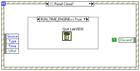

try this...as you press the "red X" , panel closes down with "quit LV" completly shutdown of application only if it is a "stand alone/run time engine" executable
A better way here would be to use the Discard? input.  In the RUN_TIME_ENGINE == TRUE case, put in a FALSE constant and a TRUE in the default.  If there are no front panels open and there is no code running, the Run Time Engine will shut down.  It is a lot cleaner than the Quit LabVIEW function since you can close things down properly.
