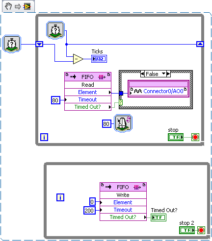

You should be able to meet the expected rate  if you use an 80 MHz clock as your top-level clock instead of 40 MHz.  I'm not sure if you can reach 1 MS/s using a 40 MHz clock.  Also, you shouldn't need to use occurrences.  Instead, time the loop with the IO Node using the loop timer.  Use a timeout longer than your IO loop on the write FIFO method to make sure it won't overflow the FIFO as long as the IO loop is running and consuming elements from the FIFO.  Here's a code snippet showing the VI I used to test all this.  I'm measuring the ticks in the top loop to make sure that the desire rate was being met.  It works fine at 80 MHz.
