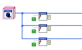

I understand this concept and I have been able to code this way succesfully. Ok, just so you understand what I actually need it for. My case looked like this:
I initialized many instances of the parent class. Nevermind the technique (if I could have used a for loop), this is just an abstraction:

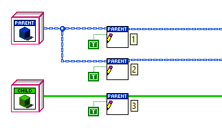

Later on I realised that 1 of those Instances will need to act slightly differently (Object 3). And I know I could have solved it this way:
But I was really wondering if there is a way to downcast to a Child class later in the code, not when initializing. So I wouldn't need to alter my initialization code. I suppose there isn't. So what I got from all this till now is:
If I don't initialize my code with the Class that is lowest in Hierarchy (may that be a child or even a grandchild), I will never be able to downcast to this class and keep the data.
So if i initialize the Parent, I will keep my parent data on the class wire, but I will not be able to cast to the Child (or Grandchild) and keep the parent Data.
If I initialize the Child, I will be able to read/write Parent data as well as Child Data and cast between those two, but I will not be able to cast to the Grandchild and keep data from his ancestors.
Only and ONLY if at the beggining of my Class Wire I used the Grandchild, will I be able to cast between ancestors and keep all the Data from the whole family. Is that correct?

Yes, that is correct.  Though, you could make a "down cast" VI in the parent that reads all of the data of the parent (static dispatch) and write it to the child object (dynamic dispatch).  But this is starting to sound like an anti-pattern.
